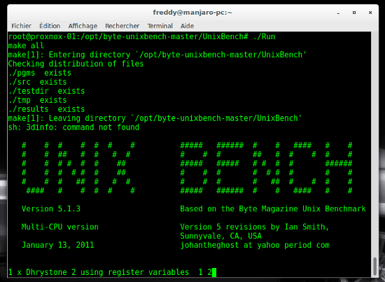

Une fois que byte-unixbench a fini d’exécuter tous les tests, il affiche une note globale de la performance du système, qui permet de comparer plusieurs types de serveurs.

Exécution de byte-unixbench :
cd byte-unixbench-master/UnixBench/
./Run

   BYTE UNIX Benchmarks (Version 5.1.2)
   System: srv30.firstheberg.net: GNU/Linux
   OS: GNU/Linux -- 3.2.0-4-amd64 -- #1 SMP Debian 3.2.68-1+deb7u3
   Machine: x86_64 (unknown)
   Language: en_US.utf8 (charmap="ANSI_X3.4-1968", collate="ANSI_X3.4-1968")
   CPU 0: Intel(R) Atom(TM) CPU D525 @ 1.80GHz (3590.2 bogomips)
          Hyper-Threading, x86-64, MMX, Physical Address Ext, SYSENTER/SYSEXIT, SYSCALL/SYSRET
   CPU 1: Intel(R) Atom(TM) CPU D525 @ 1.80GHz (3590.3 bogomips)
   CPU 2: Intel(R) Atom(TM) CPU D525 @ 1.80GHz (3590.3 bogomips)
   CPU 3: Intel(R) Atom(TM) CPU D525 @ 1.80GHz (3590.3 bogomips)
   15:53:20 up 9 days, 20:13,  4 users,  load average: 0.43, 0.29, 0.20; runlevel 2
Benchmark Run: lun. août 31 2015 15:53:20 - 16:22:03
4 CPUs in system; running 1 parallel copy of tests
Dhrystone 2 using register variables        6635293.8 lps   (10.0 s, 7 samples)
Double-Precision Whetstone                     1002.7 MWIPS (9.8 s, 7 samples)
Execl Throughput                                985.0 lps   (29.7 s, 2 samples)
File Copy 1024 bufsize 2000 maxblocks        152864.9 KBps  (30.0 s, 2 samples)
File Copy 256 bufsize 500 maxblocks           42462.6 KBps  (30.0 s, 2 samples)
File Copy 4096 bufsize 8000 maxblocks        426128.5 KBps  (30.0 s, 2 samples)
Pipe Throughput                              479323.4 lps   (10.0 s, 7 samples)
Pipe-based Context Switching                  26757.8 lps   (10.0 s, 7 samples)
Process Creation                               2599.6 lps   (30.0 s, 2 samples)
Shell Scripts (1 concurrent)                   2539.5 lpm   (60.0 s, 2 samples)
Shell Scripts (8 concurrent)                    588.2 lpm   (60.0 s, 2 samples)
System Call Overhead                        1028551.5 lps   (10.0 s, 7 samples)
System Benchmarks Index Values               BASELINE       RESULT    INDEX
Dhrystone 2 using register variables         116700.0    6635293.8    568.6
Double-Precision Whetstone                       55.0       1002.7    182.3
Execl Throughput                                 43.0        985.0    229.1
File Copy 1024 bufsize 2000 maxblocks          3960.0     152864.9    386.0
File Copy 256 bufsize 500 maxblocks            1655.0      42462.6    256.6
File Copy 4096 bufsize 8000 maxblocks          5800.0     426128.5    734.7
Pipe Throughput                               12440.0     479323.4    385.3
Pipe-based Context Switching                   4000.0      26757.8     66.9
Process Creation                                126.0       2599.6    206.3
Shell Scripts (1 concurrent)                     42.4       2539.5    598.9
Shell Scripts (8 concurrent)                      6.0        588.2    980.3
System Call Overhead                          15000.0    1028551.5    685.7
System Benchmarks Index Score                                         352.6
Benchmark Run: lun. août 31 2015 16:22:03 - 16:51:04
4 CPUs in system; running 4 parallel copies of tests
Dhrystone 2 using register variables       17318290.7 lps   (10.0 s, 7 samples)
Double-Precision Whetstone                     3588.3 MWIPS (9.8 s, 7 samples)
Execl Throughput                               2617.0 lps   (29.7 s, 2 samples)
File Copy 1024 bufsize 2000 maxblocks        150471.4 KBps  (30.0 s, 2 samples)
File Copy 256 bufsize 500 maxblocks           41316.5 KBps  (30.0 s, 2 samples)
File Copy 4096 bufsize 8000 maxblocks        455420.8 KBps  (30.0 s, 2 samples)
Pipe Throughput                              841075.2 lps   (10.0 s, 7 samples)
Pipe-based Context Switching                 152223.0 lps   (10.0 s, 7 samples)
Process Creation                               6924.5 lps   (30.0 s, 2 samples)
Shell Scripts (1 concurrent)                   4643.0 lpm   (60.0 s, 2 samples)
Shell Scripts (8 concurrent)                    644.0 lpm   (60.2 s, 2 samples)
System Call Overhead                        2490650.7 lps   (10.0 s, 7 samples)
Dhrystone 2 using register variables         116700.0   17318290.7   1484.0
Double-Precision Whetstone                       55.0       3588.3    652.4
Execl Throughput                                 43.0       2617.0    608.6
File Copy 1024 bufsize 2000 maxblocks          3960.0     150471.4    380.0
File Copy 256 bufsize 500 maxblocks            1655.0      41316.5    249.6
File Copy 4096 bufsize 8000 maxblocks          5800.0     455420.8    785.2
Pipe Throughput                               12440.0     841075.2    676.1
Pipe-based Context Switching                   4000.0     152223.0    380.6
Process Creation                                126.0       6924.5    549.6
Shell Scripts (1 concurrent)                     42.4       4643.0   1095.1
Shell Scripts (8 concurrent)                      6.0        644.0   1073.3
System Call Overhead                          15000.0    2490650.7   1660.4
System Benchmarks Index Score                                         692.3
score final : 352.6/692.3
Serveur local Dell R710 :
System:    Host: proxmox-01 Kernel: 2.6.32-40-pve x86_64 (64 bit) Console: tty 0
           Distro: /etc/ corrupted, use -% to override
Machine:   System: Dell product: PowerEdge R710 serial: DM11S4J
           Mobo: Dell model: 0HYPX2 v: A09 serial: ..CN70821051001R. Bios: Dell v: 2.0.13 date: 04/06/2010
CPU(s):    2 Quad core Intel Xeon E5504s (-HT-MCP-SMP-) cache: 8192 KB
           clock speeds: max: 1995 MHz 1: 1995 MHz 2: 1995 MHz 3: 1995 MHz 4: 1995 MHz 5: 1995 MHz 6: 1995 MHz
           7: 1995 MHz 8: 1995 MHz
Graphics:  Card: Matrox Systems MGA G200eW WPCM450
           Display Server: N/A driver: N/A tty size: 140x53 Advanced Data: N/A for root out of X
Audio:     Card pcsp driver: PC-Speaker Sound: ALSA v: 1.0.21
Network:   Card-1: Broadcom NetXtreme II BCM5709 Gigabit Ethernet driver: bnx2
           IF: eth0 state: up speed: 1000 Mbps duplex: full mac: b8:ac:6f:84:83:91
           Card-2: Broadcom NetXtreme II BCM5709 Gigabit Ethernet driver: bnx2
           IF: eth1 state: up speed: 1000 Mbps duplex: full mac: b8:ac:6f:84:83:93
           Card-3: Broadcom NetXtreme II BCM5709 Gigabit Ethernet driver: bnx2
           IF: eth2 state: up speed: 1000 Mbps duplex: full mac: b8:ac:6f:84:83:93
           Card-4: Broadcom NetXtreme II BCM5709 Gigabit Ethernet driver: bnx2
           IF: eth3 state: up speed: 1000 Mbps duplex: full mac: b8:ac:6f:84:83:93
           Card-5: Intel 82580 Gigabit Network Connection driver: igb
           IF: eth4 state: up speed: 1000 Mbps duplex: full mac: ac:16:2d:98:be:08
           Card-6: Intel 82580 Gigabit Network Connection driver: igb
           IF: eth5 state: up speed: 1000 Mbps duplex: full mac: ac:16:2d:98:be:08
           Card-7: Intel 82580 Gigabit Network Connection driver: igb
           IF: eth6 state: up speed: 1000 Mbps duplex: full mac: ac:16:2d:98:be:08
           Card-8: Intel 82580 Gigabit Network Connection driver: igb
           IF: eth7 state: down mac: ac:16:2d:98:be:0b
Drives:    HDD Total Size: 898.3GB (3.0% used) ID-1: /dev/sda model: PERC_6/i size: 898.3GB
           ID-2: /dev/sdb model: VIRTUAL size: 0.0GB
Partition: ID-1: / size: 95G used: 2.8G (4%) fs: ext3 dev: /dev/dm-0
           ID-2: /boot size: 494M used: 90M (20%) fs: ext3 dev: /dev/sda2
           ID-3: swap-1 size: 24.70GB used: 0.00GB (0%) fs: swap dev: /dev/dm-1
RAID:      No RAID devices: /proc/mdstat, md_mod kernel module present
Sensors:   None detected - is lm-sensors installed and configured?
Info:      Processes: 264 Uptime: 5 days Memory: 993.4/24094.9MB Init: SysVinit runlevel: 2
           Client: Shell (bash) inxi: 2.2.28
   BYTE UNIX Benchmarks (Version 5.1.3)
   System: proxmox-01: GNU/Linux
   OS: GNU/Linux -- 2.6.32-40-pve -- #1 SMP Fri Jul 24 11:16:05 CEST 2015
   Language: en_US.utf8 (charmap="UTF-8", collate="UTF-8")
   CPU 0: Intel(R) Xeon(R) CPU E5504 @ 2.00GHz (3990.0 bogomips)
          Hyper-Threading, x86-64, MMX, Physical Address Ext, SYSENTER/SYSEXIT, SYSCALL/SYSRET, Intel virtualization
   CPU 1: Intel(R) Xeon(R) CPU E5504 @ 2.00GHz (3989.4 bogomips)
   CPU 2: Intel(R) Xeon(R) CPU E5504 @ 2.00GHz (3990.0 bogomips)
   CPU 3: Intel(R) Xeon(R) CPU E5504 @ 2.00GHz (3989.4 bogomips)
   CPU 4: Intel(R) Xeon(R) CPU E5504 @ 2.00GHz (3990.0 bogomips)
